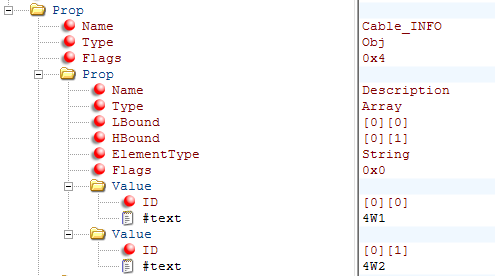

All was well until I tried to display the Cable info which is a container of three arrays.  Finding the correct xsl to parse the way the array is stored in the xml is throwing me for a loop.  Attached is a scaled down example.
how the xml is stored...

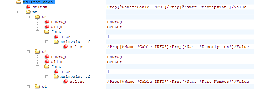

my best attempt to parse it...it loops twice but displays the same results
Any thoughts...

I have attached updated copies of your XML and XSL files. Please take a look and see if this accomplishes your goal. Let me know if it doesn't or if you have any questions regarding the changes.
