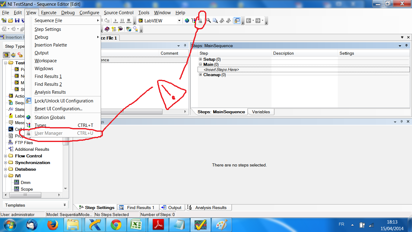

- I deleted the user.ini and restart --> The same problem
- I unistalled the TS completly but nothing changes
This picture explain what i talking about, i'm logged as administrator
