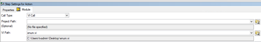

I am trying to run some code that is working on an older system, but I'm facing a rather strange behaviour when it comes to loading VIs.

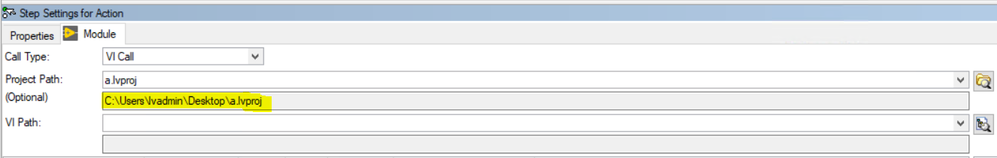

This is standard VI, but added to a project. When I open the LV project, it shows the correct path.
LabVIEW development system loads VI from LabVIEW directory as referenced by the LV project fie.
LabVIEW run-time engine fails to load the VI, because it searches for it in TestStand folder instead:
What could cause this and how could I solve it? Preferably without touching code modules.

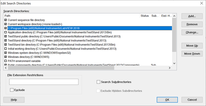

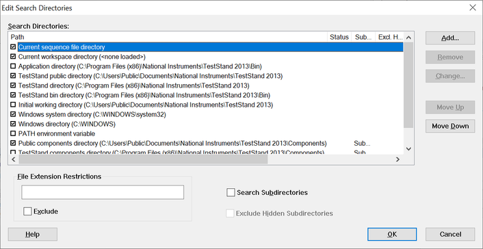

For example, this is a screenshot from TestStand (Configure -> Search Directories)
But you can add your own, as you've already figured out,
by clicking the Add button and browsing to the desired base directory,
such as C:\Program Files (x86)\National Instruments\LabVIEW 2016\
Just make sure to move it up above the TestStand directories:

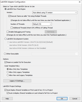

Hi, thanks for your reply. The only setting I am changing is LabVIEW adapter Server fom Development system to run-time engine.
I am not changing search directories. I did try to add LabVIEW path (with and without "search subdirectories" enabled) to search directories, but that does not change the observed behaviour.

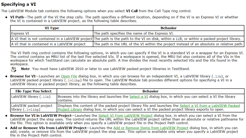

Maybe this would help (from TS help file):
LabVIEW Module Tab
