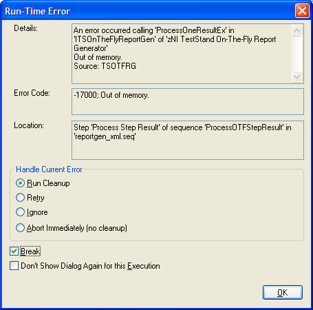

I created a simple sequence file which had a 100 Pass/Fail steps using the None Adaptor. These 100 steps in the form of 10 SequenceCall steps each performed 10 Pass/Fail step was placed in a For loop in the MainSequence. The loop was set to run 1000 iterations. The ReportOptions were set for XML horizonal, On the Fly enabled.
This I set running. Explorer was open at the folder where the result file was being stored. Two files were generated, the actual result file and a temporay file. I also had the Taskmanager open to monitor the performance.
As the result file got larger, about 20MB, I noticed that the size of the file was first set to zero and the data was written to the file. (It seemed like the file was deleted and generated each step result time). I also noticed that as the file got larger and larger, the storing of the step results was having an effect on the performance of the Test Sequence execution.
I left this running over night and sometime later the execution crashed. (see attached image). Before closing the dialog, I checked explorer to see what the state of the result file was. The both files was empty.
I repeated the run but this time the number of iteration was set to 500, again the execution crashed but this time the result file did have some data, rather a lot of data, over 50MBs.
I tried to open the file to check the contents but unfortunately my PC didn't seem to beable to handle a file of that size, as it was taking a long time to load, so I kill the process.
I dont think changing the iterations from 100 to 500 had anything to do with the getting the results on the second. I just think the point were it crashed was slightly different allowing the result to be transferred back to the file.
It would be interesting to find out whats going on the On the fly routine.

Ray,
There are known limitations of XML reporting when generating reports with a large number of results. These limitations also apply
to XML On-The-Fly reporting. The reason users might run into errors similar to the one you received is because the XML report
format generally deals with copying large strings. This string gets larger as you generate more results. The problem in particular
is that this string requires a large block of contiguous memory. You may have 2 GB of RAM on your machine but if memory allocation
is fragmented in such a way that a large enough block of contiguous, unallocated memory is not available for TestStand to store the
string in, you will receive an Out of Memory error.
