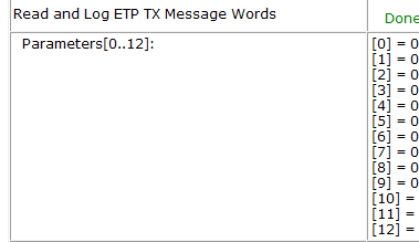

I would like the actual variable name to be displayed in the XML report instead of "Parameters".  I have tried many things to make this happen with no success.  Any ideas?

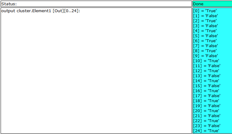

What type of step are you utilizing, and which version of TestStand are you using?  I tried reproducing this behavior in TestStand 2012 with LabVIEW 2012 using a LabVIEW action step, passing a cluster of boolean arrays, and the result was the following:

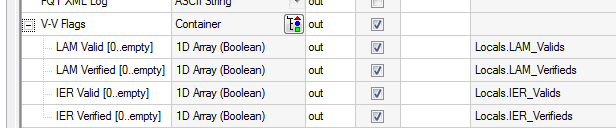

The parameters were set up as follows:
Please let me know more details about your particular step, and I will try to reproduce the problem on my side.

Ok. It must be in the stylesheet I'm using for the XML report.  I'm carrying over an older version of the horizontal.xsl due to some customizations, and the problem I've described doesn't happen when I use the latest version of the stylesheet.  Must have been a bug that has already been fixed.
