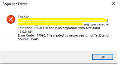

I have only Teststand 2017 license. Is there a way to import sequence written in Teststand 2019 into Teststand 2017? Getting below error when opening the sequence in 2017 Teststand

You can just post the Sequence and someone will down convert it for you. The only way I know of to open it in 2017 will be to open it in 2019, and then save it in the 2017 format.

Installing an evaluation of TS 2019 to resave your file as 2017 might be another option.
