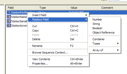

The answer to part 1
Yes. Hightlight the item to change, then select Replace Global, then you can select what to replace it with.  If the item was in a Container, then It will say Replace Field.

I'm not seeing the Replace Global option.

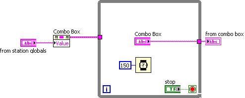

I'm not having very good success with your suggestions.   To clarify my problem, I have in my stationglobals.ini a def of
[Globals.ATEReg]
WorkCenter = ""
The first time around, if I try to read the value of WorkCenter, it should be "".  I'll place a "" in the WorkCenter control.  Then, the operator may chose from two possible enums (drop down), "MYWC" or "YOURWC".  After all other control edits are made, I'll write the new values (found in the controls) back to the .ini file.  That's how it's supposed to work.
Getting it to do that has not  been easy.  I have a TestStand - Get Property Value.vi that I pass a lookup string of "StationGlobals.ATEReg.WorkCenter".  I then create a property node with at Value listed so I can write to it.  However, LabVIEW won't let me connect the Value output of the TestStand GetPropertyValue to the Value pin (I made it a write) of the WorkCenter control's Property Node.
The type of the TestStand output is String.
Message 6 of 25
(4,933 Views)
The "value" of an enum is not a string! The default data type of an enum is a U16 number. Just look at the terminal on the block diagram. Strings terminals are red and numeric terminals are blue. You would have to use the Strings[] property of an enum to do what you want. The easiest thing for you do is to use a combo box. The value of a combo box is a string. You might want to look into taking some LabVIEW classes. Information on those and on-line tutorials can be found at http://www.ni.com/devzone/lvzone/fundamentals.htm .

I am in the TestStand Sequence Editor.  I'm viewing the Station Globals, but I don't see the Replace Global you speak of.
Message 9 of 25
(4,922 Views)
Ok,
Select a variable and then click left mouse button. you should see the Replace selection.
see attachec PNG's.
