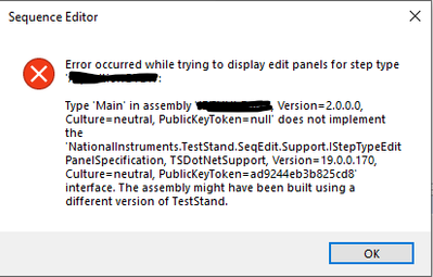

If I use TesStand 2019 with the new build (with 2022) I get an error :

From this link https://download.ni.com/evaluation/teststand/Creating_Custom_Step_Type_Edit_Tabs_in_the_Sequence_Edi...
" Each major version of TestStand will require its own build of the edit tab panel targeting the correct TestStand assembly and .NET Framework versions. "
It looks like you need to rebuild for different versions as there are dependencies on Version specific DLL while you build your DLL.
