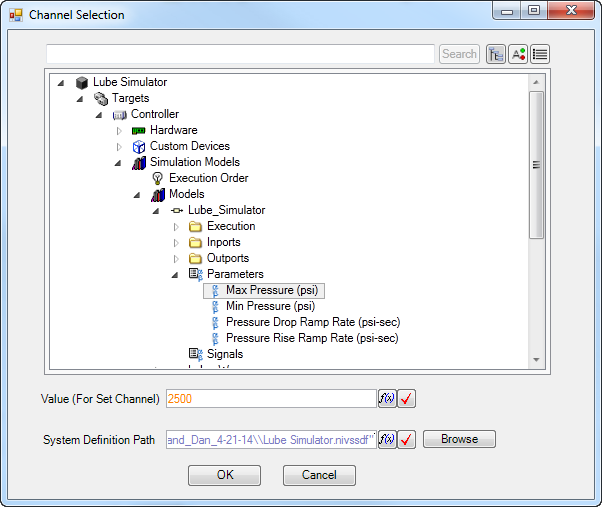

The model parameter dialog now lets you select any channel which isn't ideal but my filtering for just model channels broke in 2013 so this is a temporary fix until I find a better way to filter the tree.

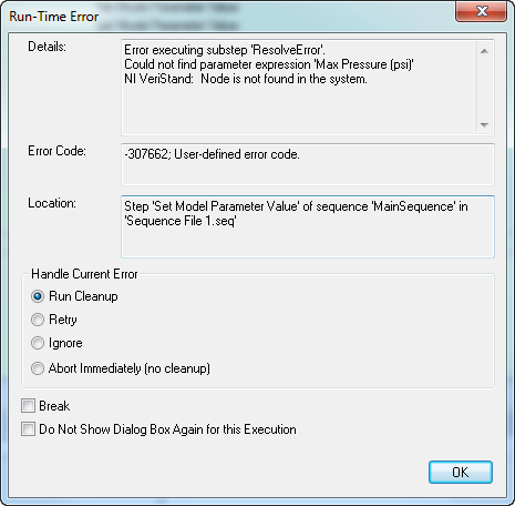

With that fix, I can configure a model parameter value.  I was using a parameter initialization file in VeriStand perviously.  Using the same parameter and value with the 'set model parameter value' custom step type, I get an error as shown in the attached photo.

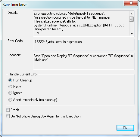

I am also getting this exception when trying to open and deploy an RT sequence...
The message indicates a syntax error, but it compiled in the stimulus profile editor.

Can you post the RT sequence you are using/the configuration of the step?
I think the parameter stuff is probably another bug, I'll see if I can figure out whats going on

Well I see the bug, if model name doesn't match the model expression then it won't work right now.  I just uploaded a fixed version. Let me know if that works for you.

It worked, thanks.  It didn't work initially with my existing sequence.  I had to delete my existing 'set model parameter value' steps and create new ones in order for it to work, but it is fine now.

I also am not exactly sure what I am supposed to be configuring in the dialog?  I already configured the variables in the sequence file.  What is supposed to go in the 'parameter value' field?
