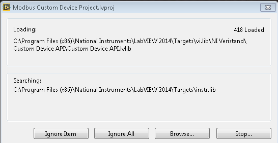

Hi Vincent_R,
My goal is to implement a real time Modbus master through veristand (using 2014). I followed the instructions above and also received a 'get main page' error. Also, when I open the project from source, it cannot find certain libraries on my computer (see below). All veristand software is up to date. Please advise.
