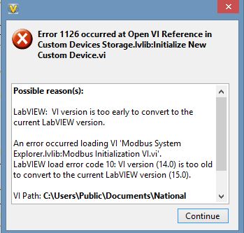

I'im trying to use the Modbus custom device in Veristand 2015, but get and error: "An error occurred loading VI 'Modbus System Explorer.lvlib:Modbus Initialization VI.vi'. LabVIEW load error code 10: VI version (14.0) is too old to convert to the current LabVIEW version (15.0)."
Seems strange that V14 is to old to convert to V15, any ideas?

So, this error happens when you open the source file in LV-2015, right?
Regards
Vincent
Message 23 of 39
(7,856 Views)
Thanks for the reply Vincent,
I should have been more clear, but it is when I try to add the device in Veristand. The message headline is: "Error 1126 occurred at Open VI Reference in Custom Devices Storage.lvlib:Initialize New Custom Device.vi"
When I try to open it in Labview 2015 I get a message saying that some of the VI's has no block diagram.Capture.JPG
Br Rasmus
Message 24 of 39
(7,856 Views)
To recap: you always need to have the Custom-Device compiled for your current version of NI-VeriStand. So, for NI-VeriStand 2015, you need to recompile the Custom-Device with LabVIEW 2015.

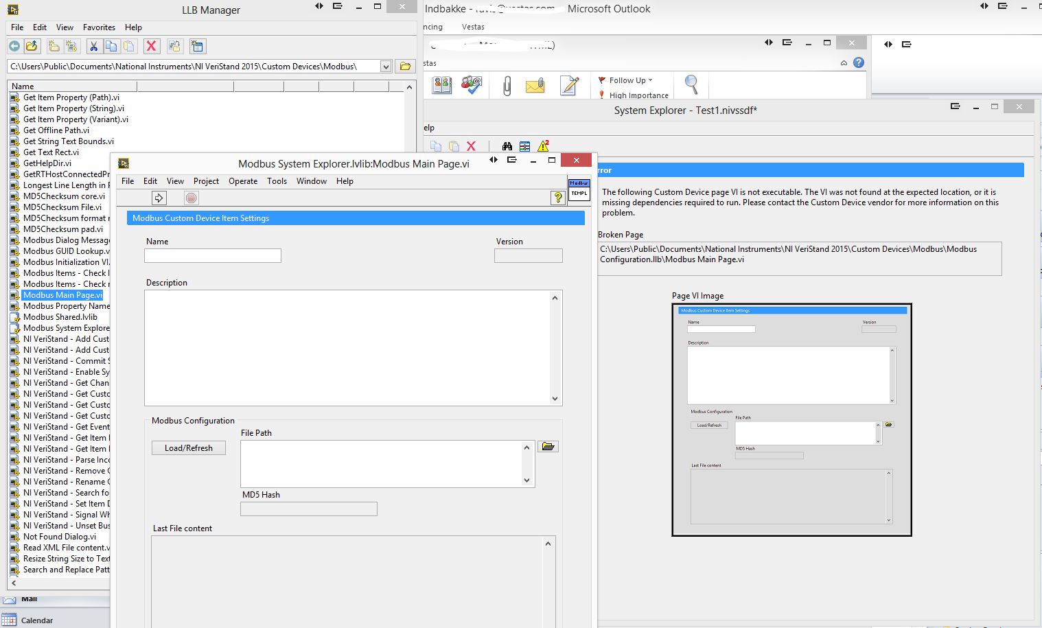

Hi Vincent,
Thanks for the recap and instruction. I think I have been able to follow you instructions, but now im facing a new problem. I know it probably doesn't have anything to do with the Modbus custom device, but I thought I would ask in here anyway.
When I add the modbus device I get an error saying the VI is not executable, but when I open it from the llb, it is executable. Any ideas?
Message 26 of 39
(7,856 Views)
I have seen that before and it was related to the .NET assembly I use to parse the XML configuration file. I don't know the details but it was not loaded and/or referenced correctly.
Ensure that you go back in the function that is used to parse the XML file (when you click the button "Load/Refresh"), in LabVIEW, you should be able to execute successfully that sub-VI by simply passing XML file path.
Let me know how it helps.
Best regards
Vincent
Message 27 of 39
(7,856 Views)
I’m not sure I understand what it is you want me to do, I have found the code related to the "load/refresh" button, but it all VI's seem to be ok?Capture.JPG
Message 28 of 39
(7,856 Views)
There is a sub-VI called "XML_Deserialize_XML_File.vi". Can you execute it successfully in LV environment if you pass right file for xsd file and valid path for a XML file?
If not, can you simply re-point to assembly which comes with source code?
Then, rebuild the Configuration part of your CD.
Regards
Vincent
