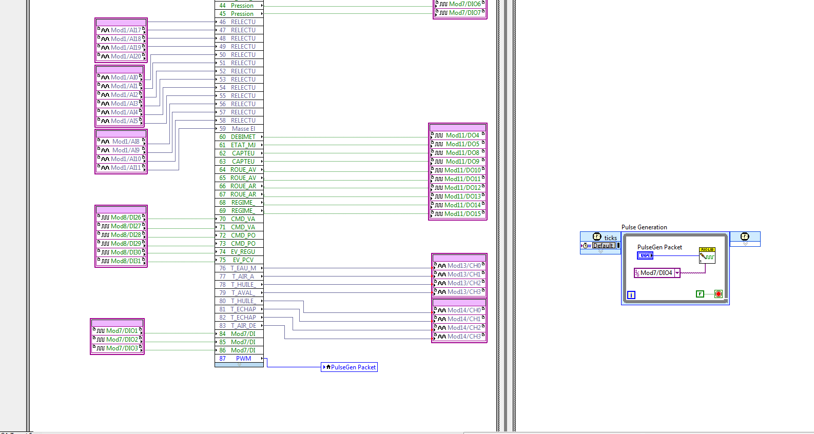

Hey Ryan,
I thank you both Ryan and Stephen for the interest have giving to my demand, after your explanations i undertand very well the frequency and ticks Fpga relations and duty cycle.
I found the Project example that you refered to me in NI Veristand Xmlbuilder node, So i did th same thing with my project i just added a Pwm output on my xmlbuilder and the timed loop genrating Pwm with a local variable In my Source Code FPGA (attached pic) , i save my VI i compile my project Fpga, after few 30 minutes the compilation fails showing the error as you can see on th attached picture.
Have you any idea about the error reason, there is any configuration to do somwhere. i want also to know if the generatin or reading PWM only works with D I/O or with other modules works as inputs(NI9425) or only outputs(NI9475), with the A I/O.
Just for information my project consist to drive an Engine simulation Toolkit which run on a MXIRIO 9159 as FPGA target, withe a Veristand Engine runs on PXI Controller.
Any helps or solution will be really appreciate

Hey AOmar,
I mis-spoke in my original reply (prior to Stephen's) when I referenced the example that installs with the node. That example will allow you to output a PWM, but will still only let you set the frequency during configuration and not on the fly. I'd recommend going over and implementing the example that Stephen links in his post so you can modify the frequency at run-time.
If you still get errors at that point then please post back with code.
Hope that helps! --Ryan_S
