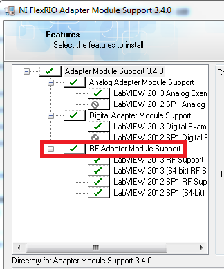

When you installed FAM support did you make sure that you had RF Adapter Module Support selected?

Yes, I checked again, LabVIEW 2013 RF support is selected.
