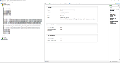

Getting Started w/ PXIe-1078, Trouble with PXI-4070 drivers, configuring MAX, using SoftDMM.
Screenshot of MAX...

Hi Jeff,
There appears to be an issue with the PXIe-8301 connecting with the host computer.
Can you send over a MAX Technical Report? This will give me information on what NI software you have install, what the computer and BIOS versions are, and what NI Services are running.

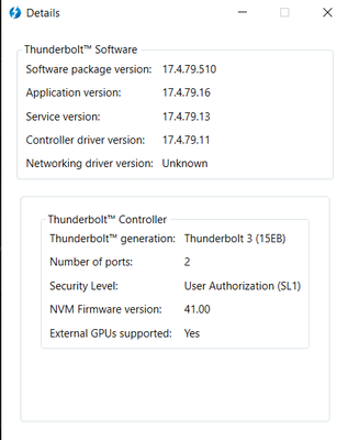

Can you also let me know what version the Thunderbolt driver is?
Thanks!

Here is the requested information and .zip file / MAX report.

Quick question, what PXIe chassis are you using? Part of the issue we're working through is that the chassis doesn't show up in MAX.
