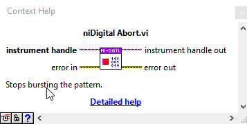

If there was a timeout due to missing trigger, make sure to call abort pattern burst and then disable start trigger.
