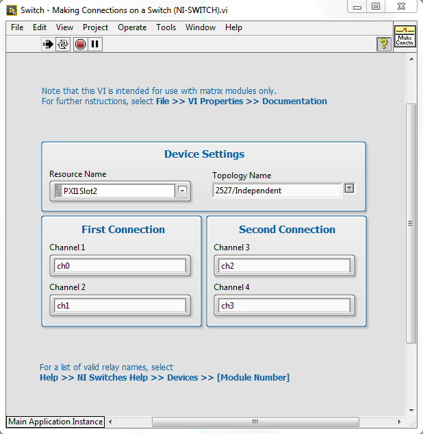

I'm simulating through NI Max the NI-2527 PXI multiplexer module. Using LabView 2015, I've opened the example vi implementing a basic usage of the multiplexer switch, here is it's front panel:

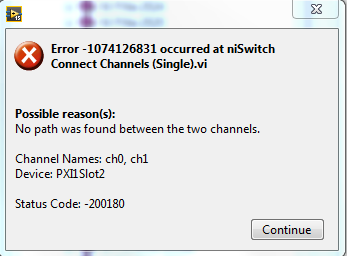

Using the independent topology, I can't connect between the specified channels. I couldn't understand from the help files documentation what channels can found route to each other. I tried many combinations but I get the same error every time:

Hi doronbehar,
As stated in the Front Panel, this example is intended for use with matrix modules only. The PXI-2527 is a Relay Multiplexer Switch Module.
Gaheel17
