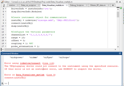

Now I have a PXI-1033 chassis with a PXI-5105 digitiser to get some samples/ real data. The NI-scope SFP works well now and it shows the waveform successfully.
May I know how to put the waveform from the NI-scope SFP to MATLAB?

I cannot connect the matlab to the NIscope. Do anyone have the same issue?

It doesn't look like MATLAB is seeing the NI-Scope driver. I believe it should get listed after the disp(driversInfo.Modules) command. At this point, you might want to reach out to MathWorks for help since the scope is performing correctly in NI MAX. We don't really know MATLAB over here at National Instruments.
