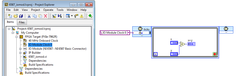

The project you attached didnt have the FPGA vi included in it so I'm unable to tell if you were using the IOModClipClock0 properly.
Anyway, attached is a project that has the IOModClipClock0 added to the target, and an FPGA VI that uses it to run some logic in a single cycle timed loop.
