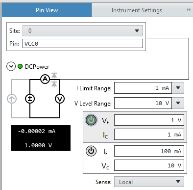

We use digital pattern editor as a soft-panel, among other things.  It works for the PXIe-6570 outputs, and for nidcpower instruments like PXIe-4141 (below).  One good thing about it is that it is pin based.
I was hoping to bring a pin-view like this up so that I could inspect the DC voltage at the PXIe-6345 analog inputs.  Can it do that?
In the pin-map, how should enter the 6345 information?
