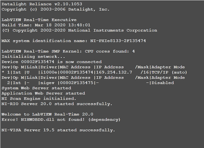

On the PXIe embedded Controller I get an Error:
NIHDBDD.dll not found (dependency)
I don’t know if this is connected.
I recently updated my PXI from LAbview 2012 to Labview2020. I didn’t have this problem before updating.
Also on the Monitor connected to the embeded controller I get the message that NI-VISA Server 19.5 has been started succefully. However, in NI MAX under software of the PXI it tells me that NI-VISA 20.0 is installed.

The problem was that the SCB-68 was defect which I attachted to PXIe-6363. I replaced it since than it works. the dll not found error was apparently unrelated to it. I could resolve this issue by de installing everthing from National Instrument through the package manager and trough windows "add or remove programms" settings. Additionaly, I deleted the folder of National Instruments in Programs(x84).
