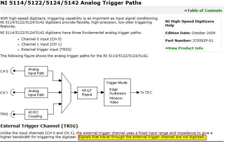

Hello bmann2000,
Please see the screenshot, found from the NI Digitizers Help at the following link:
http://zone.ni.com/reference/en-XX/help/370592P-01/digitizers/5122_analog_trigger_paths/
NI 5114512251245142 Analog Trigger Paths - NI High-Speed Digitizers Help - Nati_2011-08-08_11-34-26.png
I have highlighted the sentence that gives additional information regarding the jitter.   The EXT Trig line is an Analog Interface which directly accepts the signal.  Filters are in place to reject jitter.  The digital triggers going through the Signal Routing Matrix are being digitized.  Therefore, I believe that several samples of the digital signal must be taken to avoid 'false' triggering.  This could be causing the jitter.
My US colleague has informed me that the digital trigger lines have a specification for PXI_Trig trigger delay and holdoff, however, they do not have a written specification for the actual jitter, such as the one seen for the Analog EXT Trig.  Furthermore, we have not found any features of the NI-Scope driver that can change the operation of the Signal Routing Matrix.
Achieving triggering with the lack of jitter will be possible by using the EXT Trig line.  Please let me know if there are any additional questions.
