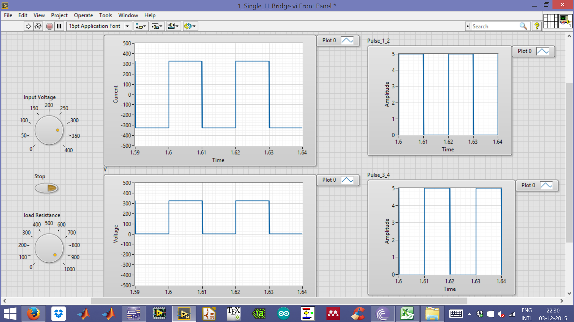

This is the correct output in multism with both positive and negative voltages..
But see below in labview,  only positive output..

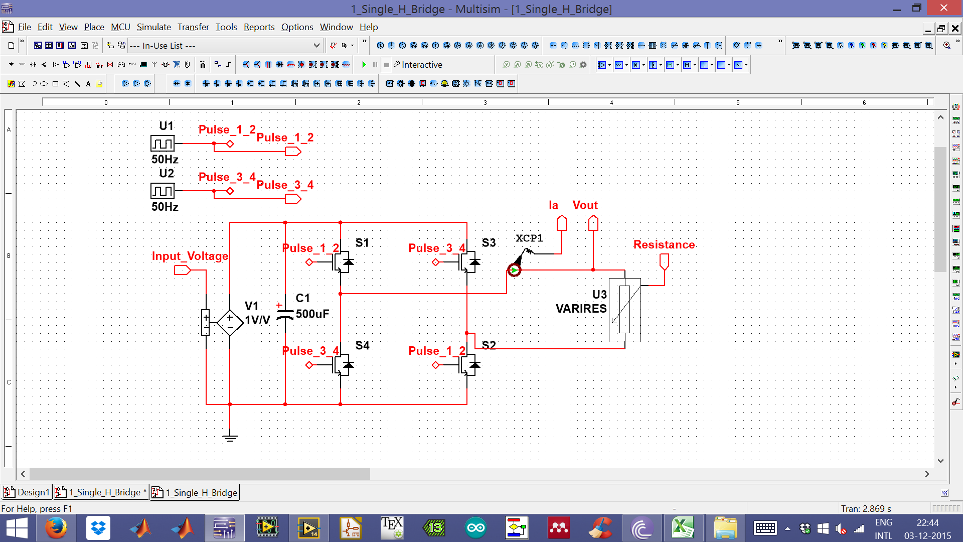

Well your currents are going negative which means that the voltage should go negative.  What if you put a connector on the negative side of the variable resistor and look at the difference?
