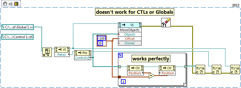

Concerning a possible workaround for error 1035 on "Move Objects" when applied to Control VIs
First: As I can't look into the VIs with my latest LV-installation of 2013, my proposal might be nonsense.
Why not iterate over all controls in question with the Control property "Position" instead of using the above mentioned VI method? I illustrate my idea in the attached image.
Hope this helps
