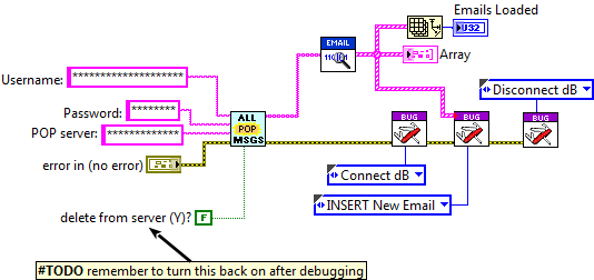

We wrote a bit of code to plug the email details into our bug reporting database (this gives us a metric of how quickly we respond to an issue for ISO9000).
We can then query the database and search for any new emails in the system, this is done on a button press with my pretty email button.

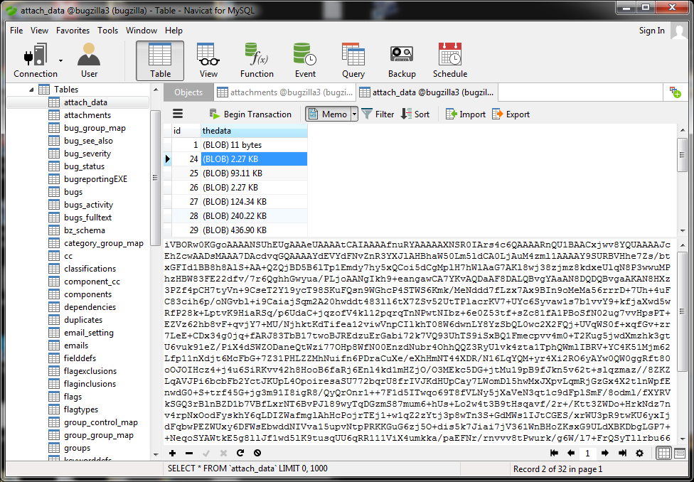

Email is sent as text and therefore the attachment will need encoding into data that is safe to transport. The most common method appears to be base 64. For us base 64 is pretty marvelous for encoding blobs in databases (Binary Large OBjects) for similar reasons to emails we don't want spurious control characters as part of your SQL query. In fact I would now recommend encoding any entered free text as base64 into a query.
Here is how it looks in my database.
So the only time I want to decode it is when I display the attachment.
