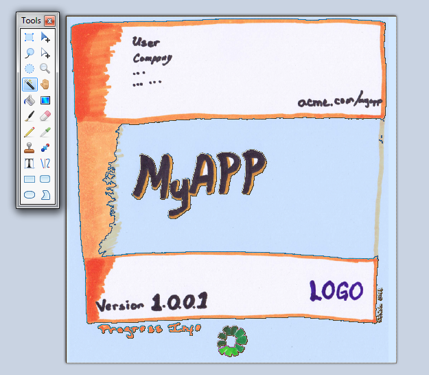

This is the pretty bit, first lets get the graphics. Cut and paste the image into Paint.net and use the magic wand tool.
![]()  | This selects a block of colour that you can delete (make transparent), Delete any thing else that you are going to replace. In this case I deleted the progress, version and link to the website. |

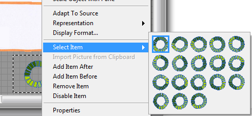

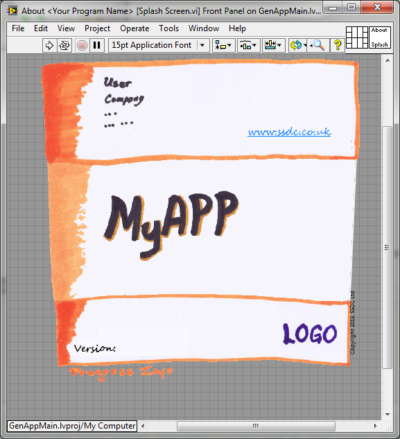

| Next we load this into our splashscreen VI by Edit>>Import Picture to Clipboard... like this | ![]()  |

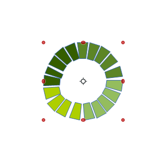

The progress indicator is simply a ring control made from a rotated metafile created in LibreOffice.
