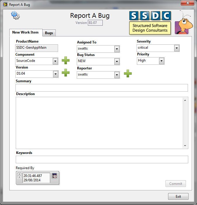

Then I put in a bug reporting screen.

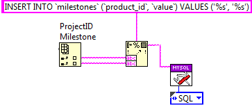

We can then take the generated SQL and make this in LabVIEW.
We just replace the variables in the query with %s and away we go.

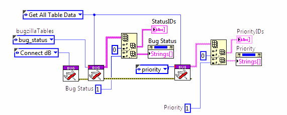

The other aspect of Bug Reporting is to see the status of the reported bugs.
I put in a filter that controlled my queries, preloaded with all the status's (already loaded this for the previous screen, so just a menu item on the string)
Another right-click menu item allows us to edit the bug.
Because I don't want to maintain the bug reporting screen on all my projects I make it into an executable and have it as separate project. I call it using the command line and use command line arguments to pass the project name.
This is the bug reporting screen for our Project Management Utility. I add some posh splash screens etc to the build, the final bit of the puzzle is to get it to update itself. Here's how
