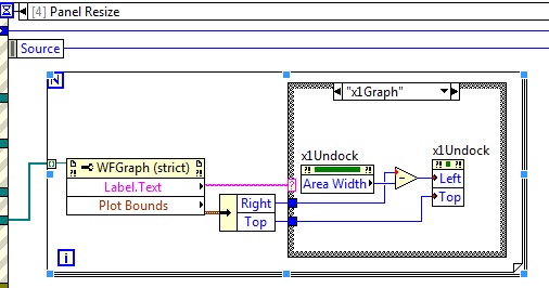

The first challenge here is to make a button that keeps its proportions, and is locked to a position on the graph. I want it to always be in the top right hand corner of the graph. Aesthetically I want it to be unobtrusive (i.e. use transparency to make sure it doesn't get in the way of the graph). I made a line drawing in LibreOffice Present and cut and paste this into a vertical button (from the UI Control Suite:System Controls Palette). The easiest way to restrict its size is to set it as a Strict Type Def. Finally we need to lock it into the top-right hand corner of the graph, sadly the only way to do this is writing code!
x1Undock is the button, so we take the width and move it relative to the Right of the Plot Bounds of the graph.
This is code worth noting as you'll be using it a fair bit, due to the fact that LabVIEW is natively a little random when left to its own devices!

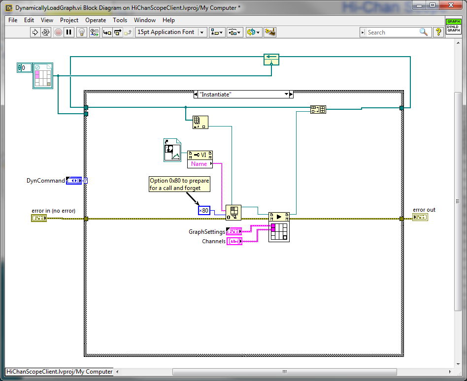

Pressing this button will instantiate a graphscreen.vi instance, pre-loaded with the settings from the docked graph.
Keeping control of all the dynamic references in this manner has worked out nice, it allows us easy housekeeping and access to control and indicator values.

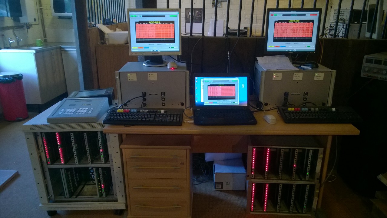

Update 09-Feb-2016: Here's a picture of the system, just after it's Lloyds Register factory test was completed.
