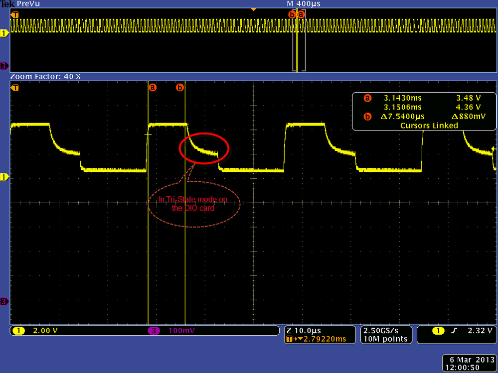

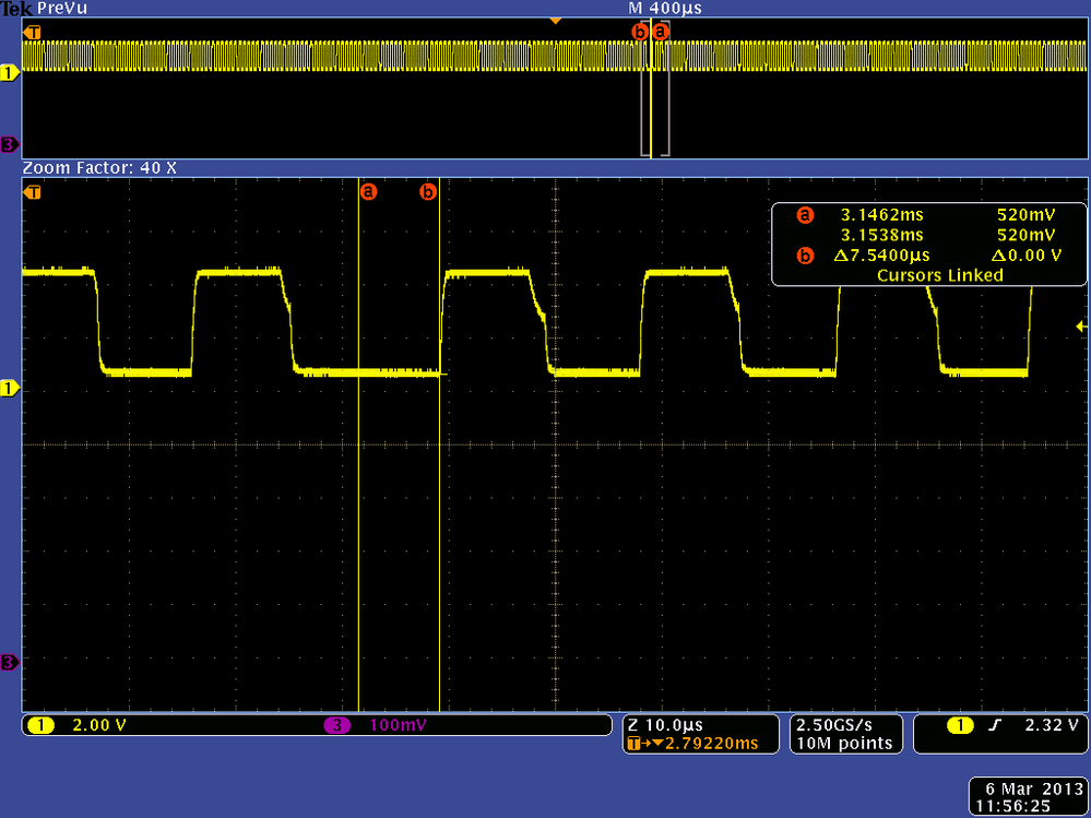

1.)    The data collected/generated is not deterministic. As seen in scope capture NonDeterministic.tif a clk trail is low for almost twice as long as it should be. Also the frequency is not as I would expect in a 1Mhz timed loop. I would have expected  a  500Khz clk. Instead I see about a 72Khz clk.
2.)    When I perform a data read on port0 the data out on port 3 is reset as seen in the scope capture WithReadEnabled.tif. Data port 3 goes into a tristate mode when performing a read operation on port0.

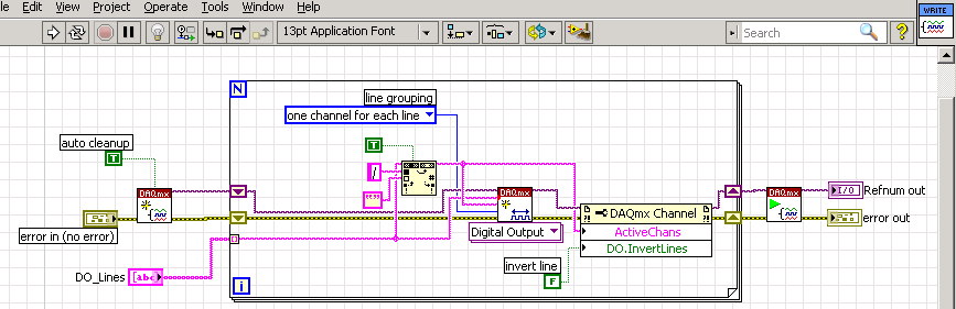

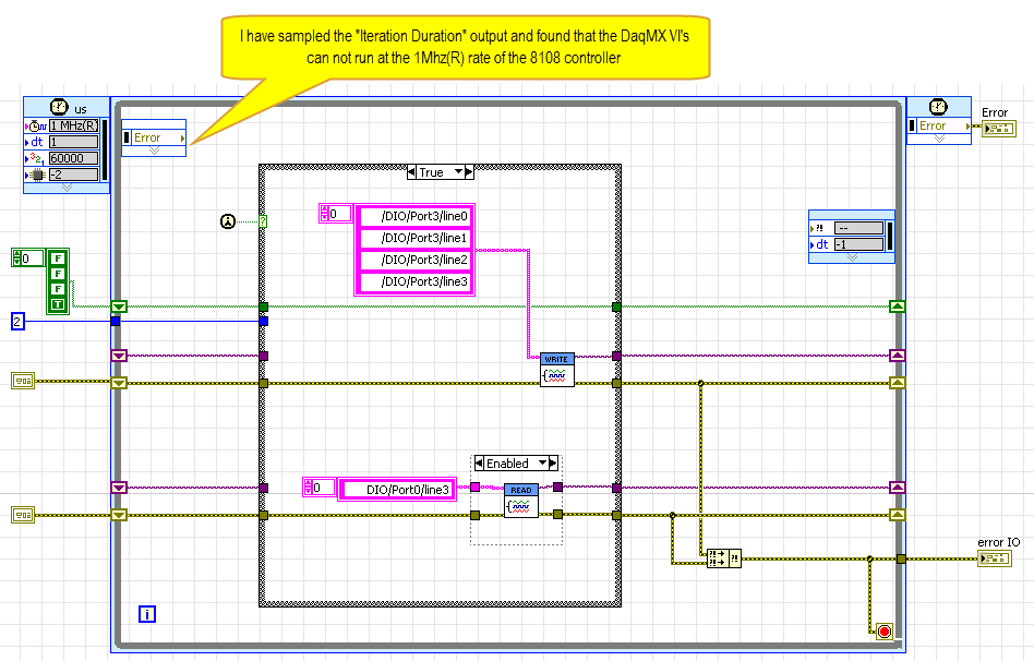

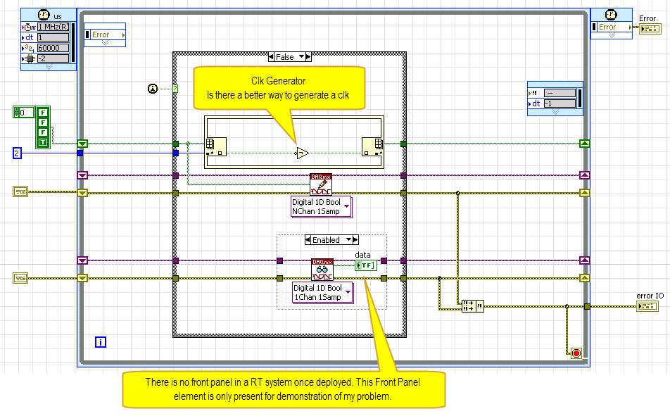

The image of the LabVIEW code is a simplified example that I made to help narrow the issue.  The scope captures are taken after active signal conditioning and not directly from the card. But anytime the port is in a tristate mode it floats to about 2 volts after conditioning.

I'm discovering that it takes about 8us for a DAQmx task to do anything with this card.
