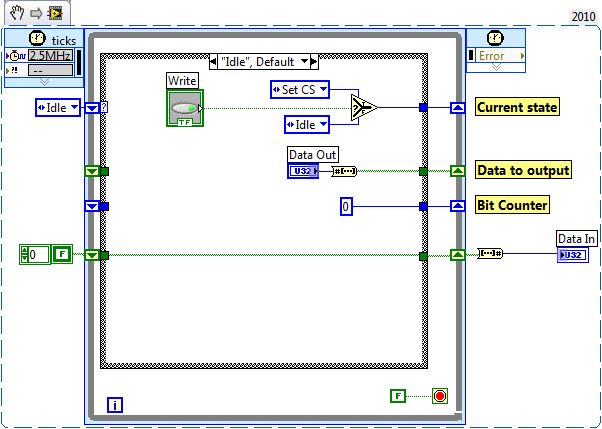

So today I tried the example FPGA SPI MASTER (SCTL) from here http://zone.ni.com/devzone/cda/epd/p/id/3458
I added extra wait states for the transitions between the CS and SCLK and seems to work fine. However, how do I include the MISO support (Reading from the slave) for this example? If this all works fine I will just make a DMA and fifos to the HOST.VI and job done 😉

I tried added the MISO and simulation looks ok. But do not get any data when I loop MOSI and MISO togethor. Could you please look at my code and edit it so that it works. Smiley Happy Been struggling a day trying to get this working, Really need to get the SPI up and working ASAP. Smiley Sad Thanks...

Well I got the MISO integrated and works. Kind off. For some reason when I simulate its fine. But if I run the code on the target it adds bits!! Input=1, output=4, input=2, output=8 and so on.SPI.png

What do you mean when you say simulation? Do you use a custom VI to handle the data? Are you using run on development computer with real I/O?
If I understand correctly, you are outputting 00000001 and you get back 00000100, or 0010 and you get back 1000, right? So you are sending 2 false bits more than you wanted, either before or after the rest of your data. Do you know which one it is? Another important question: my understanding of SPI was that it fires on a rising edge, yet yours seems to read data on the falling edge. Is that your intent? Another thing to look out for is race conditions--the FPGA is much faster, which may explain why the simulation is working but the FPGA is not. Perhaps add a few sequence structures to your code, to make sure everything happens in exactly the right order.
Past those points, I can't see anything clearly wrong with your code. Just make sure you are following the protocol properly as I described above. When things are happening at 5 MHz, you cannot be too careful about timing.

Hi, Could you please edit the code too what you think it should be. Smiley Happy Really stuck on this issue....Thanks
