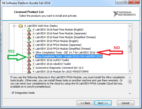

This is the method to install FPGA on Win10 LabVIEW 2015,2016
1.The installer will INCORRECTLY prompt you to install 'all' the FPGA tool kits when you select 'LV FPGA' Module- Select 'NO'LV FPGA Install Step 1.png
2. Then Select the  'Vivado' Xilinx tools only...NOT the ISE 14.7 toolkit.
3. Select 'NO' a final time when the installation prompts - yet again - to install 'all' the FPGA tools.
This will install the FPGA development and xilinx compilation tools.
Regards
Jack Hamilton
