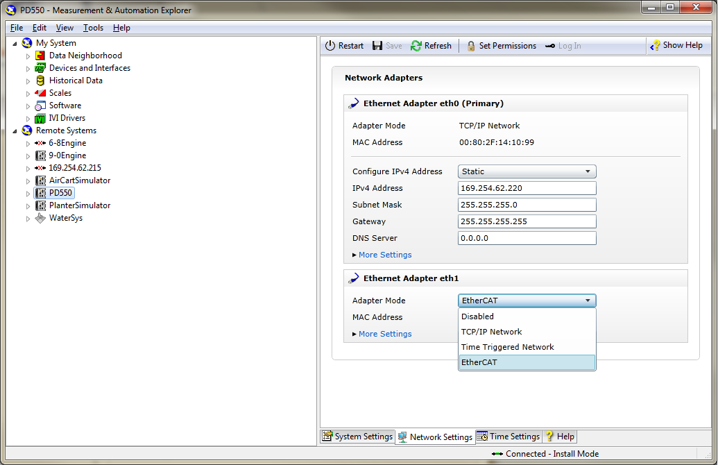

I have been using a cRIO 9082 as an EtherCAT Master.  In order to do this, I had to change the 2nd Ethernet adapter to EtherCAT.  The only way that MAX allowed me to change the adapter settings was in Install Mode and the only way I could figure out how to get it into this mode was by starting the Add/Change Software and changing a piece of the software, then canceling after it rebooted the cRIO into Install Mode.  I'm currently writing a company document so that others can set up a cRIO as an EtherCAT Master and I feel like there has to be a better way to boot into Install Mode other than this.
If the cRIO is just "Connected - Running" in MAX, it keeps "Checking the target for permissions" (this might be due to some firewall settings that my computer has that I cannot change) and never populates the Network Settings and if I boot it into Safe Mode, changing the adapter to EtherCAT is not an option on the drop down.
The two screen shots to the right are when the cRIO is in Install Mode.  This is the only way I've been able to change the second Ethernet adapter to EtherCAT.
