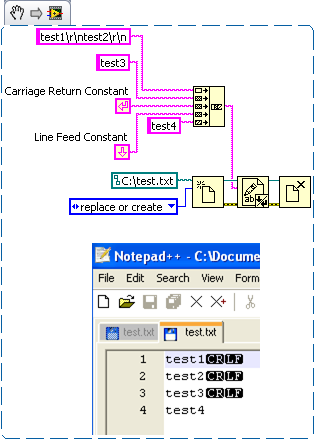

Bill,
I ran some code on a Phar Lap-based controller, and I can't replicate what you're stating.  I see the [cr][lf] options existing for a file created on Windows and Phar Lap.  Here's the code I ran along with the resulting file.  (The file was identical for both OSs - Windows XP and Phar Lap.)
I do know that some different behavior can exist between [cr] and [lf] values when using a VxWorks-based real-time controller.  This article outlines some of these differences: Why Is There a Formatting Difference between Files Generated in VxWorks and Phar Lap?

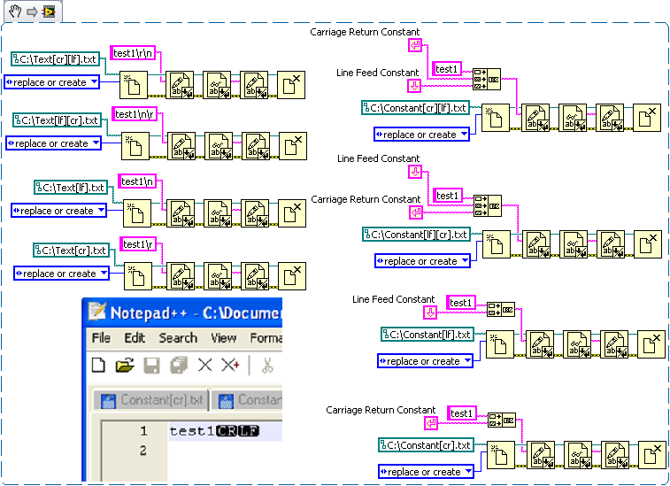

Bill,
I had trouble seeing some of the detail in the image.  (If needed, post a VI snippet.  ...remember about some of the caveats if using Firefox or Google Chrome browers.)  I've got at least one comment though regarding it - why are you closing the file reference multiple times?  You only need to close the file reference once.  (Open it once and close it once.)  I see a potential issue there.
In lieu of your code, I wrote some more test code.  I get the same consistent output each time - on Windows and Real-Time (Phar Lap).  No matter what permutation I do ([cr][lf], [lf][cr], [cr], [lf]) I always get the same output in Notepad++ (being [cr][lf]).  I even wondered if reading from a file and writing that same data back to the file causes a conversion, but I saw no difference.  Here's my code.  Have you been able to identify at which point in your code the "conversion" takes place?
