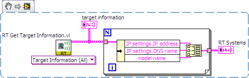

You didn't specify the LabVIEW version you are using. In LabVIEW 2009 you can use the RT Get Target Information VI to get a list of all RT targets on your local subnet.

Hi Dadiala,
There is a VI on the real-time utilities palette that will find systems on your subnet and return their info.
It's called RT Get Target Information.vi
Kurt
