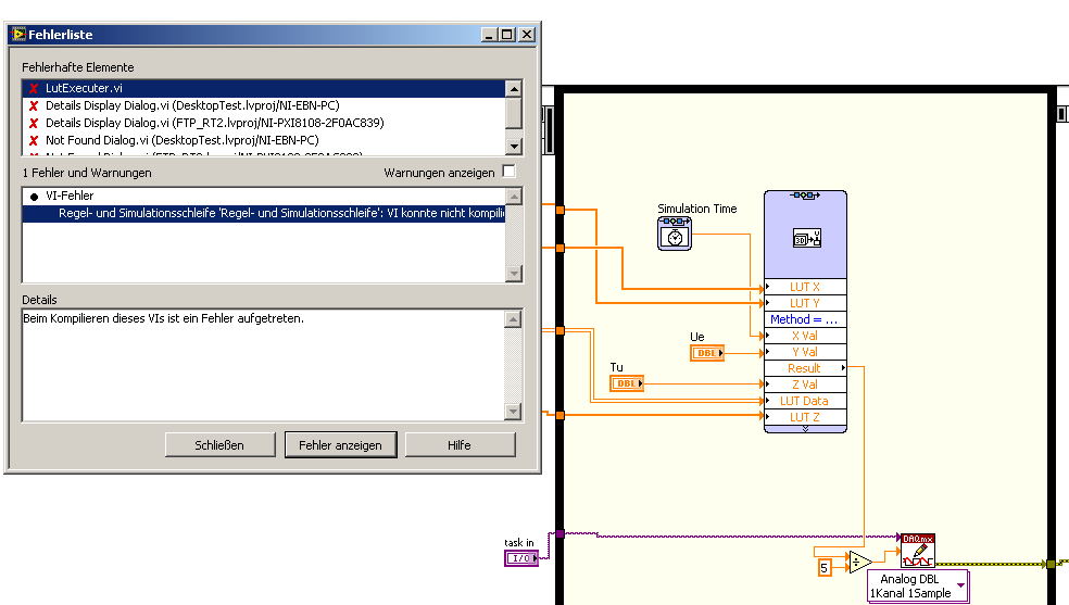

When I use a Lookup Table in my simulation/control loop, the VI gets broken sometimes (broken run arrow). I can not solve this other than to restart the VI from zero.
I am using LabView 2009 SP1, this error occurs on other PCs with this version of LabView as well.

Addition: The error seems similar to the one decribed here -> Knowledge Base
The hints did not help. But when I resize the "Lookup Table" VI-Box via mouse, the run arrow gets white and ready again, but only until I click the run arrow. Clicking it will result in a broken arrow and a "failed to compile" error message once again.
The problem described here only occurs when using "Lookup Table" VIs.

Addition:
I noticed, that the "Lookup Table" VI looks different on my LabView 2009 installtion:
As you can see, the white input/output frames are missing. But this VI version does not lead to a "failed to compile" message.
Why does it look different? Every PC uses 2009 and Sim/Control 9.0.0....

None of the icon styles seem to match the first picture. And bad luck for me: even this different look was't a solution. The VI is once again broken. Even reverting the single change I did can't restore the runnable state.
I tried to move the broken VI from remote RT to "My Computer" and back again (without doing any changes). This seems to fix the broken arrow (as long as I do not touch the VI's block diagram). This must be some LabView Sim/Control bug...
