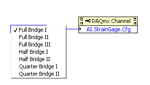

DAQmx provides all of the major "type" variations for each of the three main bridge configurations.  The possible configurations are shown in the AI.StrainGage.Cfg DAQmx Channel property node as shown here:
However, NI-DAQmx does not include rosette gauge support.  I would encourage you to file a  product suggestion for consideration by our R&D engineers.  This would also be a good forum to suggest more complete TEDS documentation for NI-DAQmx.
