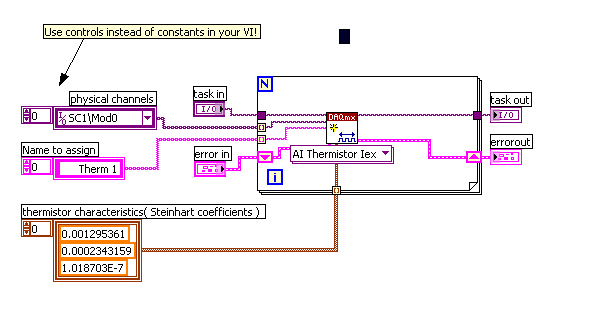

Do your 'Create Virtual channel' step as shown in Pic.
Now you can add different Steinhart coefficients ( array of Thermistor parameters) for each corresponding 'Physical Channel' ( from Physical channel array)

I used exactly the same diagrom as you mentioned here.  I think my problem is in the For loop.  The DAQmx Create Channel (AI-Temperature-Thermistor-Iex).vi is in the For loop.  The Task out signal is wired to Task in DAQmx Timing.vi through the tunnel.  If I disable the indexing of the tunnel, only the last sensor channel is passed to the next vi block.  If I enable the indexing, there is broken wire.  Hope this clearify my problem.  Thanks for any comments.

If you replace the tunnel for the DAQmx task with a shift register it will, in effect, remember all of the channels that you are creating.  The DAQmx task will be wired similarly to the way the error cluster is wired in the For Loop, as seen in the Thermistor_create channel.PNG above.

If you run your code in highlight execution you will see that your For Loop only runs one time. If you enable auto-indexing for more than one tunnel the count becomes the smaller of the choices. For example, if two auto-indexed arrays enter the loop, with 10 and 20 elements,
the loop executes 10 times, and the loop indexes only the first 10 elements of the second array. So in your program you need to either make your thermistor characteristics array larger, one entry for each channel, or just tunnel the thermistor data in without it being an array. Then the For Loop will run more than once.
