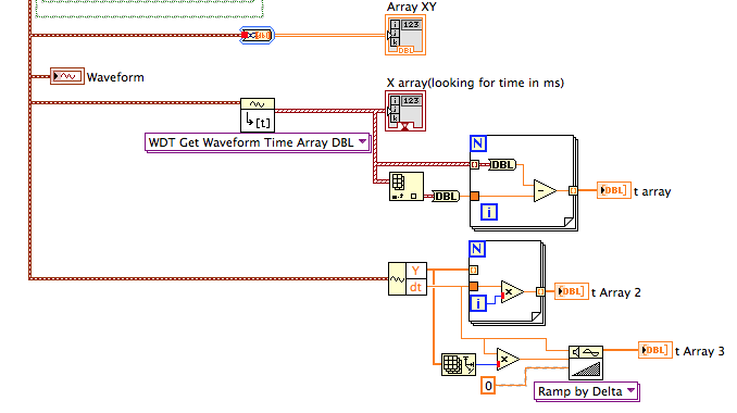

2.I couldn't extract the corresponding time in millisec,all I have been getting is time stamp,showing Date,YY:MM:DD:HH:SS which is not usable for plotting and curve fitting.
3.When I wrote the output of the trigger and gate VI to an array,I only got the Y value array,the time array the did not show up.See array XY on the front panel.

2.Converted the dynamic dat from the trigger and gate VI  to a waveform and to a time array.This shows time stamp 1/1/1904 see the front panel.
3.Tried using a get waveform time array.

The way waveforms work is to take advantage of the fact that signal sources which produce waveforms (DAQ or software) generate uniformly sampled data. So only two pieces of information are required to preserve all the timing information: The start time, t0, returned as a timestamp, and the sampling interval, dt, returned as a scalar. The amplitude data is in the Y array. Export Waveform to Spreadsheet file saves the timing information in the header.
The waveform at the output of the Trigger and Gate VI has dt = 0.00100 and t0 = 1/1/1904 (which is the "zero" value of a timestamp). So the necessary information is there.
When you need an array of times for something like the fitting VIs, you need to create it yourself. You probably do not need the start time. You can create the X array by several methods. Convert the timestamps from WDT Get Waveform Time Array.vi to DBL and subtract in a for loop. Multiply dt by i in a for loop. Use Ramp Pattern.vi. These three methods are all shown in the image below. All create arrays with 0, 0.001, 0.002, 0.003 ...  In your case I would probably use the method wired to t Array 2 (dt*i).

Thanks for your prompt response,time and explanation.You have solved the problems!The options worked fine.I am now making progress.Thanks once again.God bless you.Amen.
