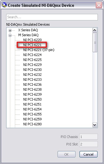

Hi wbf,
DAQmx is the driver and beyond installing the one driver, there is no additional software required for DAQmx.  You are correct that you should have the ability to simulate a 6221 device, which is part of the M Series family.  What version of DAQmx do you have installed?  This may be found in Measurement and Automation Explorer (MAX) under Software in the Configuration window.  Will you please post a screenshot of the simulated devices that you have available in addition to a note about which DAQmx driver is installed?

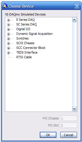

DAQmx is 8.5.
List of devices included, note the list is incomplete and M-series is specifically missing.
As background info,  this computer originally had 8.5 installed, which worked fine .  We were given what has turned out to be bad info that an upgrade was required, and attempted to upgrade to 8.7.  The upgrade failed completely with numerous cryptic error messages, and MAX would not even run.  Repair would run without error, but software was still non-functional.  8.7 was removed, and 8.6 install was attempted.  This proceeded without error, but resulting list of devices was even more limited, and repair was also unsucessfull in restoring functinlity.  8.6 was then uninstaled and now we are attempting to return to the previously working 8.5, without success.  There are ambiguous error messages generated during the install.  Repair can be run, and then MAX will run, but with a tuncated list of devices.  There does not seem to be any way to verify the installed devices or to add any that are missing as in this case.
