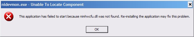

In an attempt to move forward, the caps folder was renamed and the repair process run on all nine NI modules.
The repair process completed without error, however at the conclusion of the repair, there was no new Caps directory created.
Now when the target is booted, the following new error dialog appears:
This error dialog did not appear prior to running the repair.  It appears the error-free repair process has further corrupted the install rather than repair it.  Prior experience is that re-installation will not fix this problem.
Please advise.

       It would appear to me that you've done a lot of troubleshooting, and it looks like Heather has done significant homework as well.  At this point, I understand not wanting to upgrade your driver because things haven't gone swimmingly in the past.  However, if it were me, I would run remove all of your NI drivers and start fresh, installing only NI-DAQmx 9.0.2 (as Heather had previously suggested).   Have you been turning off your anti-spyware software while doing installations?  I know that the first error that you were getting is a Windows error, however, there is not clear documentation of remedying it.
When you go to Control Panel»Administrative Tools» Services are you able to start nidevmon.exe (or the NI Device loader)?
Either way, it's becoming more obvious that you have a corrupt installation.  A good question to ask at this point is, what is different about this computer than the other computers that work (mentioned in your first post)?  You may want to refer to a thread like this one that discusses doing a clean install.  Have a good one!

At this point, I understand not wanting to upgrade your driver because things haven't gone swimmingly in the past.  However, if it were me, I would run remove all of your NI drivers and start fresh, installing only NI-DAQmx 9.0.2 (as Heather had previously suggested).   If you had done YOUR homework, and actually read the posts, you'd know this has already been done, and the recent error dialogs posted are the result of the failed 9.0.2 install.
Have you been turning off your anti-spyware software while doing installations? Yes.
I know that the first error that you were getting is a Windows error, however, there is not clear documentation of remedying it. I cannot possibly be the first customer to encounter this error.  NI created this installer package, and you have NO documentaton on errors which may be encountered when running it?!?!?
When you go to Control Panel»Administrative Tools» Services are you able to start nidevmon.exe (or the NI Device loader)?  This service is not present.  There are nine services which reference NI or National Instruments.  All show stated, none of them resolve to nidevmon.exe or 'NI Device Loader'.
Either way, it's becoming more obvious that you have a corrupt installation.  Really?  Reread post #1.  You'll note corrupt installation was my original complaint.
A good question to ask at this point is, what is different about this computer than the other computers that work (mentioned in your first post)?  The most obvious difference is the Target machine had a working install of 8.5 when this whole mess started.  That is also noted in the prior posts.
You may want to refer to a thread like this one that discusses doing a clean install.  Thank you for the info.  I note the posts making these references date from 2005.  How unfortunate it takes 13 posts to your support forum to finally dig this out.  Unfortunately, other than the deletions of the specific registry keys noted, these actions have already been taken without resolving the issue.
