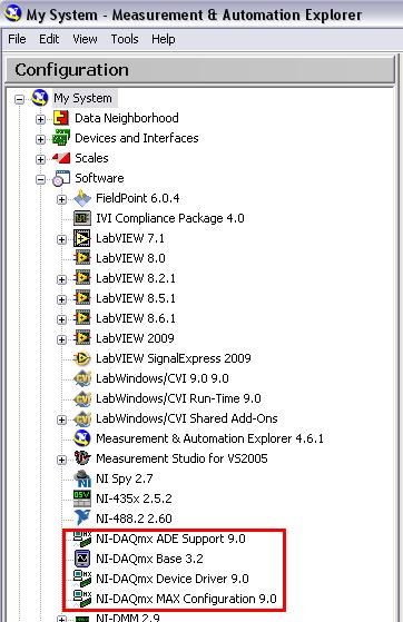

HI Andrw,
DAQmx is the driver that interfaces with the NI-9237.  You may not be programming explicitly with it; however, the driver is making the low level calls.  You may check your driver version under software in Measure and Automation Explorer.  If you are using a version of DAQmx earlier than 9.0, then you will have only one reference.
