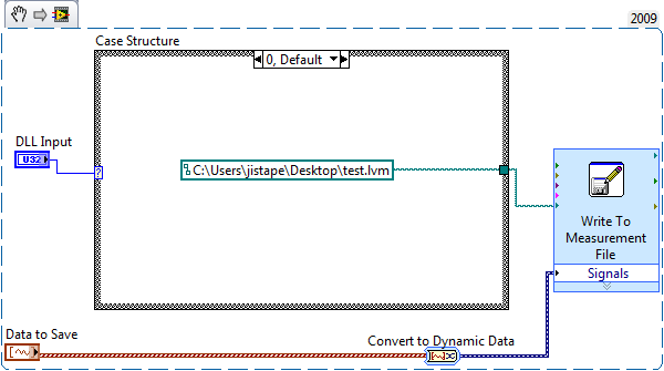

After reading over your post, it looks like you are receiving a value (0 or 1) and depending upon that value your want to save your save in a different folder. After looking at the functions you can use in Signal Express, there isn't a way to do this. I would suggest creating a LabVIEW VI that to do this. In order to do this in LabVIEW I have shown a picture below that you could add to signal express to choose where to save the file.
After this is created, this KnowledgeBase can show you how to add this to signal Express.
