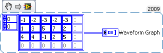

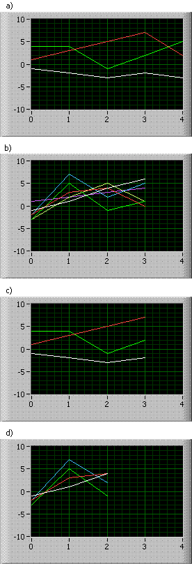

Which of the following graphs is showing the data written to 'Waveform Graph' following execution of the VI?
NOTE: Assume the Transpose Array option for the graph is set to OFF (do not transpose).

Well, there's 3 rows, so 3 plots.  That eliminates b and d.
There's 5 colums, so the plot should go from 0 to 4.  That eliminates c.
So the answer is A!

Well well Crossrulz way of elimination was great. I go with A since there are 3 colums and 5 rows so the output should be A.

Ans:A

Ans:- A

Answer: A Nice one crossrulz, gnshmrthy, Neelamma & Pratibha.
Nice explanation crossrulz.
