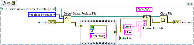

What is the size in bytes on DataFile.txt following execution of the VI?
a) 0
b) 18
c) 19
d) Undefined (a file is not created)
