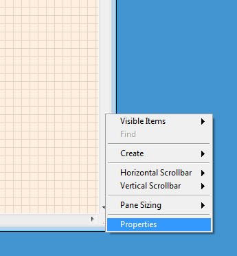

Pane Properties Menu
Right clicking on the left-hand scrollbar of a VI allows access to the Properties menu for the pane.
Pane Properties Dialog
From the Pane Properties screen you can browse to a background VI.

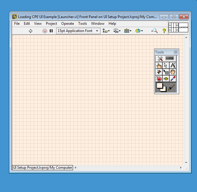

Setting up a splash screen:
There are lots of examples for splash screens available.
This one is particularly helpful.
I varied this a bit so the splash screen only lasts until the main code finishes setup.  If your code has a fast setup, then a splash screen is probably going to be more annoying than helpful.  If you have a bit of loading and setup though it may be helpful to let the user know what is going on.
This project doesn't need a splash screen, but does need a launcher, so I will make the launcher look nice.  I'll also include in the sample code a full splash screen config.

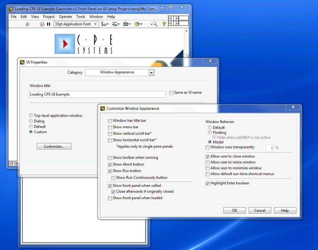

Splash Screen Window Appearance
Splash Settings Window Appearance.
Notice the Title is set to something specific and the screen is modal

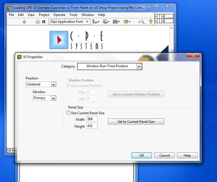

Splash Screen Run-Time Position
Splash Settings Run Time Position
Your splash screen should usually be centered and set the pane size appropriately for your image.

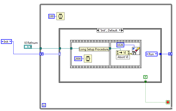

Launcher Code
Launcher Code
My preferred approach to splash screen launchers is to close the splash screen only after setup is complete.  So, I pass the launcher VI reference into the main vi to be closed after setup.
Main VI Code
Main VI Code closes the launcher.
Again, this is specifically for long setup VIs so the user knows what is going on.  You can put an animated gif on your launcher front panel or you can cycle a picture ring control as in the linked example.

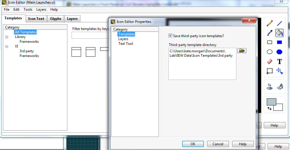

Check Template Directory
Template Directory
My templates were not reliably showing up in LV 2016, though they were great in 2015.  In the icon editor you can look at properties via the Tools menu and check your directory. My 2016 directory didn't have the same path structure as previous versions.  The referenced directory doesn't exist so I changed my path.  It still didn't show up immediately but after restart and clicking on all the sub categories they did.

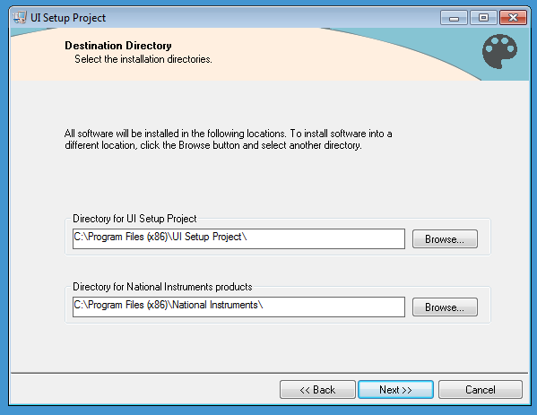

Installer Screens:
The example I used for this no longer links with the community upgrade, so I will post what I did and if anyone can find the link to the first person who originally solved this I will add the link.
After creating and compiling an exe for your project you can create an installer and customize the screens.  The screens need to be correct DPI, size, and format to work.  It’s easiest to open the attached installer art and edit or paste over it.
Installer Dialog Information
In the Dialog Information section of the installer you can check to include custom welcome graphic and banner graphic.  These graphics files need to be part of the project.
Installer Art
Example install.  The example Welcome Screen has blue boxes to show you were the text and progress bar go.
Example Installer Continuation
Install continues.  There will be text in the top area but there is room for a logo on the right.
