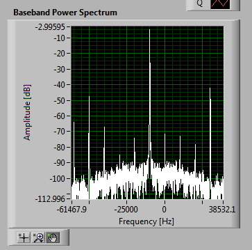

I assume that when you say spectrum, you mean that you are looking at the power spectrum.  I tried this out on my USRP to see if I get the same behavior.  When I ran the VI (attached, very basic.  I just combined the RX and TX examples) with the Baseband Power Spectrum X and Y axis autoscaled, I saw what looked like the noise floor changing.  However if I changed by X and Y axis, I saw very stable behavior where my spectrum looked like this (units on the graph are off):
Also if you are seeing the main lob widen, this could be an indication of phase noise.  Make sure that your cables are all connected securely and not damaged.  If this is not the behavior that you are seeing let me know.  And once again, feel free to post screen shots or code, I can easily try it out on my system to see if I get the same behavior.

- Yes. The power spectrum. Sorry for my vague description.
- No.  This was not an issue of axis autoscaling.  With autoscaling off...there were still significant changes in the power spectrum.  To verify this... x output into my PXI spectrum analyzer (NI 5660) and observed the same behavior.
-  The behavior only occured when I was running both my Tx and Rx loops in the same VI simultaneously...so I felt that it was more likely my code rather than the hardware.  If I operate JUST the Tx example program or JUST the Rx example program...there was no issue.
