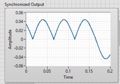

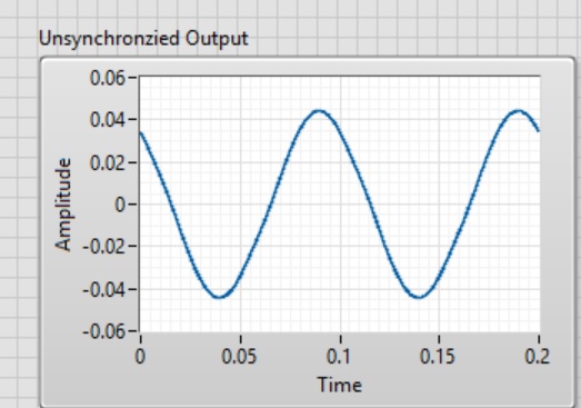

I try to observe both phase-synchronized and phase-unsynchronized received signals. The phase-synchronized output is supposed to be identical to transmitted message signal while phase-unsynchronized is supposed to be affected by phase distortion. The problem is the phase-unsynchronized output is identical to transmitted signal (!!!) while the phase-synchronized output is affected by noise, which means the result is totally reversed. Here is the outputs:

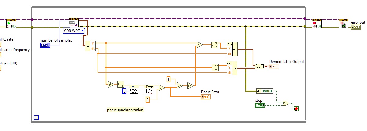

Hi khdl,

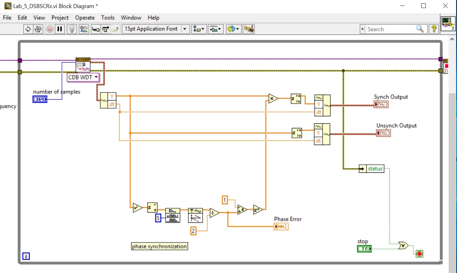

I think you have coded things correctly and maybe just the graphs are mismatched. Looking at your code, the phase synchronization is done to the first waveform in your array and the second waveform is the unsynchronized waveform. Even though the phase synchronization code was at the bottom of your block diagram, it's actually applied to the upper waveform in your diagram.
To make sure you can just have 2 graph indicators in your VI instead of building an array and displaying both in one graph. That can help you clear up any confusion as well.

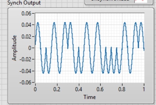

I thought so but I used separate graph monitors to make sure they are not mismatched. Look at the results please, they are still the same:
I'm sure something is wrong but I can't find it 😞

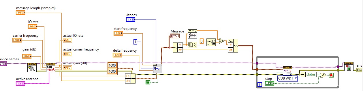

For transmitter, I just generate sinusoid signals and scale it down (due to ADC constraint in USRP) then make a complex signal and transmit it over the channel. Here is my transmitter:
Thank you for your support,
--Kash
Message 6 of 11
(5,988 Views)
Hi Kash,
Let me know how your testing goes. I don't see any glaring mistakes on the transmitter either so I'm a little stumped on where this error could be coming from especially because you are seeing the right behaviors just on the wrong channels.

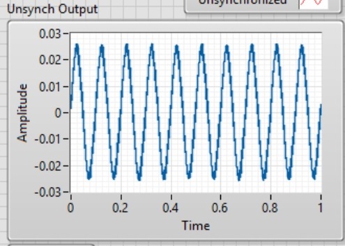

I ran the Median Filter with default parameters but I didn't see any changes.

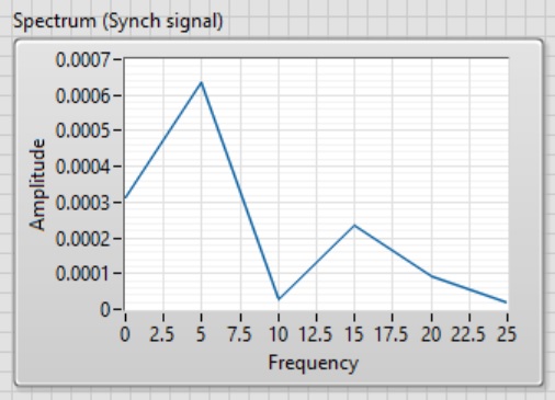

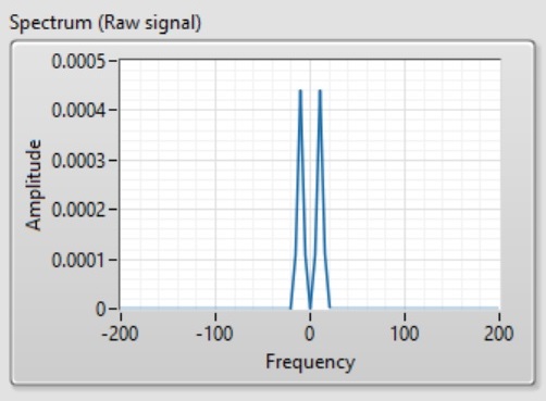

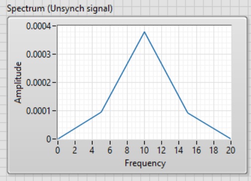

I used "Power spectrum and PSD" vi to see the actual frequency of the received message in both synch and unsynch cases. The message signal is a sinusoid with frequency of 10 Hz. Here is the result:
 spec_1.jpgspec_2.jpgspec_3.jpgYou can see the received frequency is 10Hz at unsynch output but we have more than one received frequency at the synch output (5Hz and 15Hz).

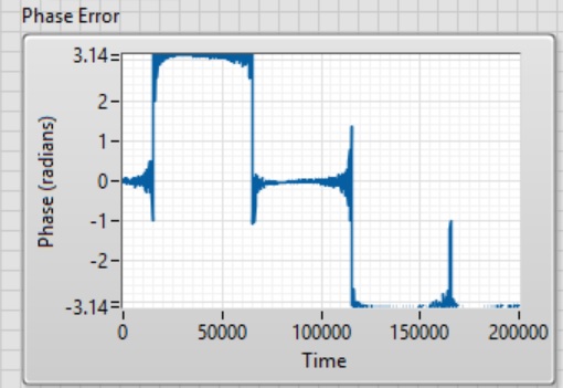

I guess there is no phase difference between transmitter and receiver and "phase synchronizer" is only extracting the +10Hz and -10Hz frequency, dividing them by two and adding them to message frequency.
I hope I'm not doing something stupid.
--Kash

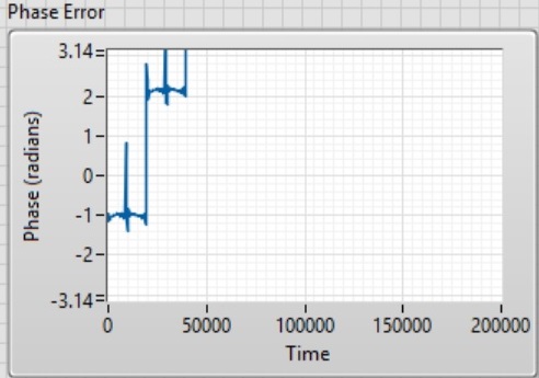

Hi Kash,
I do think the Synch signal you're getting is a little weird. However, I do think the synchronization you're doing is working. The goal of the synchronization you're doing is to eliminate the cos(theta) phase error term. However, the error in theta manifests itself in the form of a gain constant once cos(theta) is evaluated.
This means that when looking at your unsynchronized signal, the amplitude could be different every time. However, your synchronized data should have the same amplitude every time. I think that's what I'm seeing from your data. I am expecting the signals from the synchronized and unsynchronized channels to be the same aside from the amplitude. I'm not exactly sure why your synchronized waveform looks so different.
James F.
Applications Engineer
Message 9 of 11
(5,960 Views)
