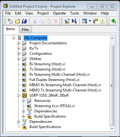

I'm having trouble finding the exact VI you're using and settings you're changing. In order to create a USRP RIO sample streaming project, I load LabVIEW, select "Create Project", select "NI-USRP" in the left pane, and open the "Simple NI-USRP Streaming" example.
I then have this project window:
Is your project similar? And if so, which VI are you changing your settings in?

Hi Rick,
I am using "Rx Streaming (Host)" vi. with the settings shown in figure below. Sampling-rate is 3.125 MSPS and num-samples=1040.
I have also attached the figure of "Start-Trigger" which is a subVI of "Streaming XCVR FPGA", where AUX I/O-0 is acts as the source of trigger when we select "Digital-Edge" in the Host VI.
    Adeel
