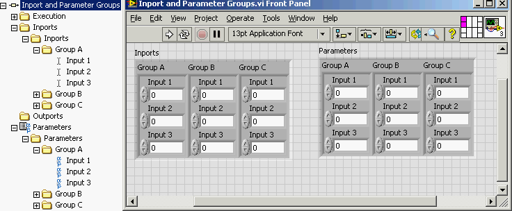

you can use single level clusters as well.

Supported data types are listed in this document.  A supported cluster will import as a virtual folder.  Clusters can be nested to provide additional organization in the System Definition.

Haa the cluster nesting looks promising. I am going to try that!

So far so good with Clusters as well.
