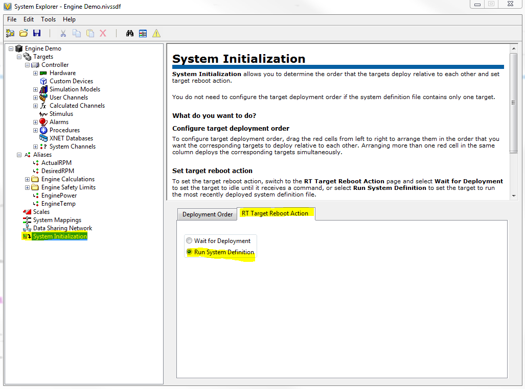

Hey Claudio_G,
You can have your System Definition automatically run when the target is powered on by checking the Run System Definition option from the System Initialization>>RT Target Reboot Action tab in the System Definition.
Hope this helps!

Ah!
That part where you never click on anything below the mapping 🙂
Thanks for the highlight!

Perfect, that is exactly what I was looking for! Thank you.
I usually disconnect my PC (Laptop) from the Real-Time PXI after my project has been deployed and running. But I would like the PXI to resume running the project on it own in case there was a power interruption.
