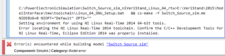

       I have installed Matlab 2014a, Visual Studio2012 and Eclipse 2014 in my computer. The operating system is windows 7.  And the veristand frame work model is succesfully deployed to matlab-simulink as shown in the command window in Matlab.
       But when I'm trying to build a .so file for my cRIO through"Simulation---->Model Configuration Parameters--->build", while using "NIVeristand_Linux_64.tlc" as system target file.  The complition is successful but during the building process, here comes the error as shown below,which said that my Eclipse was not installed properly.  And it's very strange that even I unistalled the Eclipse 2014, the error is the same. Is there anything wrong when I installed Eclipse 2014, or is there some special configuration after installing Eclipse 2014?

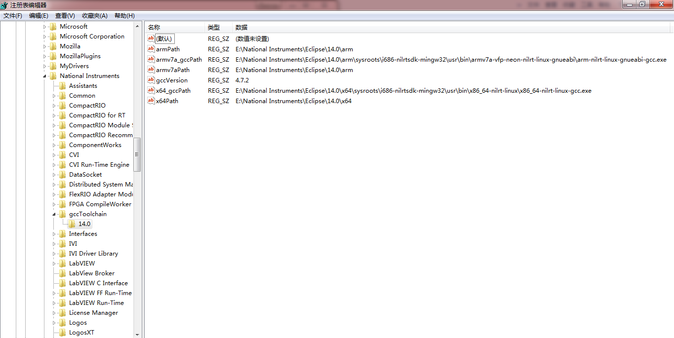

Thanks a lot Nestor!
I have run the cmd with Admin Previlage and run the test file again, but the result is the still the same.
My window 7 is 64-bits. The following is the content in the certain locatioin of the registry, and it seems the same as what you have provided above, including the x64Path.
Weily
